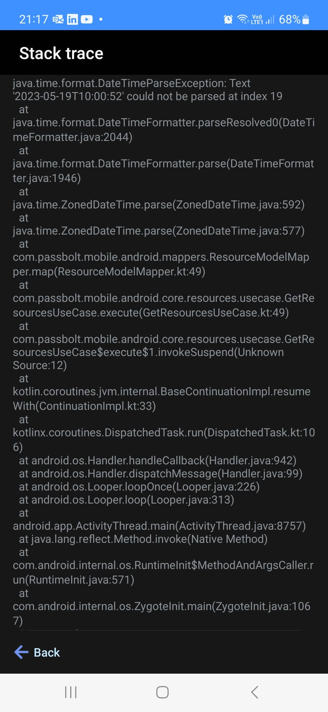

I manage to trap the error in Android for reporting puproses, see details below:
  • Exception class name: java.time.format.DateTieParseException
  • Source file: DateTimeFormatter.java
  • Source class: java.time.format.DateTimeFormatter
  • Source method: parseResolved0
  • Line number: 2044
Stack trace attached as image:
Thanks and kind regards

The issue points to a parsing error in Java… it seems more an unhandled exception to me… isnt’t it?

Hello @zipelkopf , we have the exact same issue reported on GitHub: App Crashes After Login (DateTimeParseException) · Issue #4 · passbolt/mobile-passbolt-android · GitHub concerning installation from source; Basically, for some reason, there is no time zone information in the dates received from the backend and mobile uses ZonedDateTime for parsing, so it treats the date as invalid. We’ll see how to proceed with that and let you know.

Based on the Android stack trace that I provided earlier, would it be feasible to handle in Android the different date/time format that may be returned? Perhaps jsut adding the missing index[19] to the date/time parameter before being parsed?
