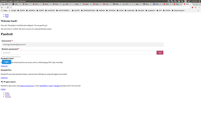

@remy, when i set appurl to ‘https://my_domain’ , it gets stuck on “loading, please wait”, but when i set appurl to
“https://my_domain/passbolt”, i loged sucessfully and my profile page looks just fine, but login page looks like this:
