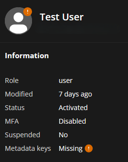

The issue is after I add a new user account, when the new user activates their account the application logs the following error message to /var/log/passbolt/error.log:
2025-07-28 20:51:40 error: The metadata private key cleartext data is not valid. Metadata key could not be shared with user id: 98971b6a-f4de-4aee-8ce2-e4e03a33f83d.
In the GUI, the user’s information shows the metadata keys are missing
Everything else in the application seems to work fine. Existing passwords decrypt and you can add new password entries. The app and db health checks pass. This issue did not exist on the old server. I had added a new user just a few days before the server failed and they activated with no issues.
