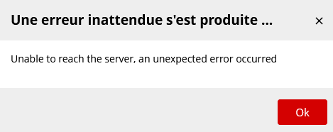

Now that I have shared my parent folder with my group (With 7 users), if I try to add user into the group. I have this error at this end of the sharing.
If I create a new group, add users and then share the parent folder with this new group it works.
The problem come from the adding user operation.
You need to have a look at the error logs inside /var/log/passbolt/error.log you will have more information about the error
Hello, I do not find anything in error.log but I have found something is /var/log/nginx/passbolt-error.log :
2025/04/10 11:26:17 [error] 743#743: *17165 client intended to send too large body: 9442419 bytes, client: 192.168.X.X, server: 192.168.X.X, request: “PUT /groups/a55dc1a1-2e80-4fa4-9bc6-949dcb6d584f.json?api-version=v2 HTTP/2.0”, host: “…”
Can you increase the client_max_body_size inside /etc/nginx/sites-enabled/nginx-passbolt.conf
and after that do a sudo supervisorctl restart nginx
Thanks!
