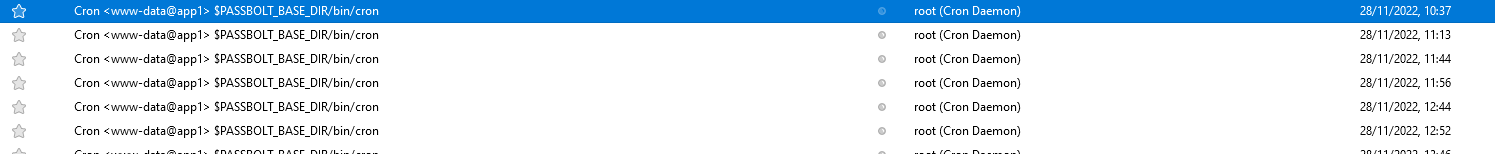

Same problem here, but not while installation process… Everything was working fine until the last debian package upgrade (Debian 10.5).
Cron is working fine, the health check is fine also. When I try to reconfigure mail server in the interface, it’s correctly saved.
But, got still this error every hours : Exception: The OpenPGP server key cannot be used to decrypt the SMTP settings stored in database. To fix this problem, you need to configure the SMTP server again. Decryption failed.

@max it was not through Rocky Linux. My setup is a Passbolt instance which is running since at least 2 years on Debian 10.
And It was not on an installation, it was really on a running instance. That’s why I am sure this bug comes with the last (not the one of this week) upgrade. Problems started exactly here :
2022-11-28 09:53:48 upgrade passbolt-ce-server:all 3.7.3-1 3.8.1-1
In [/usr/share/php/passbolt/plugins/PassboltCe/SmtpSettings/src/Service/SmtpSettingsGetSettingsInDbService.php, line 114]
@pabloelcolombiano , I ended up upgrading from version 3.8.1-1 to version 3.8.3-1 on December 2nd and it resolved the issue. The email alerts from cron stopped.
