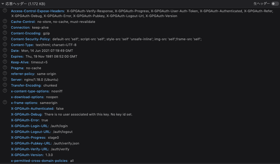

Hi @remy
This is login page response header.
x-gpgauth-authenticated -> false
x-gpgauth-login-url -> /auth/login

This is login failure page.
That is strange, it seems that the user cannot be found. According to the debug message:
there is no user associated with this key. No key id set.
Did you complete the setup without any error?
