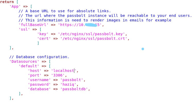

Hi, I’m still newbie on installing software that need to be configure with server or hostname etc. I have this problem (I stated on title) when I sign out, I can’t sign back in. I use oracle virtual box with oracle linux 8.5. I follow the guide and everything when smoothly but this error occur when I try to sign in back. I use mariadb as my database and nginx for webserver. And for the hostname and URL I use my own ip address 10.x.x.15/24. When generating the keys I use my own personal email as the server email and 10.x.x.15 as my server name. Is it because I don’t have ssl? And last but not least while I still sign I do try send email to add user to other people. They do received the email but they cannot open the link. The website cannot be reach. I would be really grateful if u can help me. Thanks in advance.

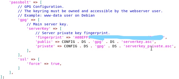

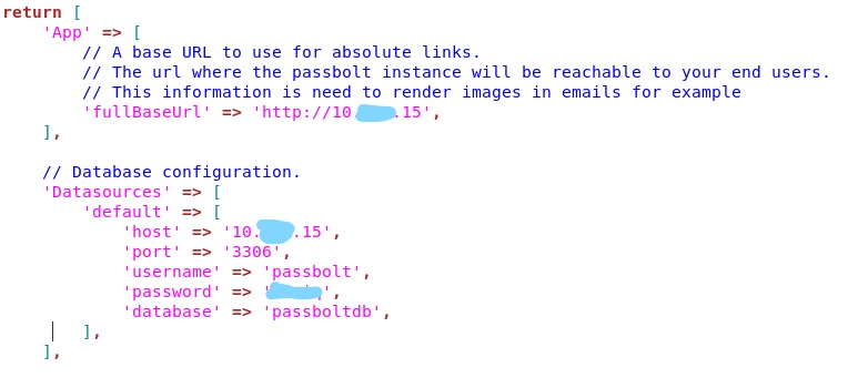

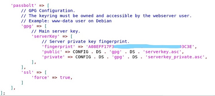

This below is screen shot of my passbolt.php:

In your passbolt.php config, try db host value of localhost instead of the ip address of the server. Does it make any difference when changed?
Also, you have force ssl but your full url is not showing https. This is a conflict.
Nothing change. For the force SSL, I already add the SSL cert and key but it is a self signed one and it is not valid so should I change it back to http:

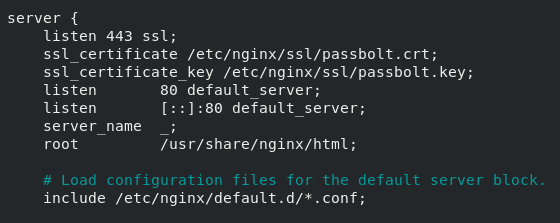

The ssl right under fullBaseUrl is not correct and can be removed.
Those keyand cert values can be in the nginx config:
ssl_certificate /etc/nginx/ssl/passbolt.crt;
ssl_certificate_key /etc/nginx/ssl/passbolt.key;
Also, once you have it working, rotate your server keys as described here, since you have published the fingerprint. Passbolt Help | How to rotate server GPG keys

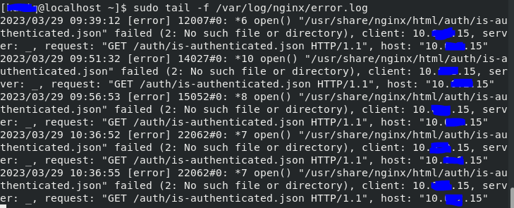

Everything returns fine except when I open the error.log it says:

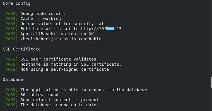

And after that I make a passbolt health check for user and then for nginx. user only give fail because off ssl and logs but for nginx it says that it does not have permission to open /var/lib/passbolt/.gnupg and also the secret_key is not inside the keyring.
I try to give permission to nginx and then the user will pop error because of that (permission). And right now the user is the one that need permission for the .gnupg and the keyring
It’s not clear at the moment which nginx config file is which… however, the root that we would be expecting would be something that includes passbolt/webroot at the end of it.
Like: /usr/share/nginx/html/passbolt/webroot
With package installations it would be root /usr/share/php/passbolt/webroot; but maybe you installed using source or it’s an older install?
I check the file dir but there is no directory for
/usr/share/nginx/html/auth/is-authenticated.json
in there even I unhide all the file it is not to be found. I do have /passbolt/webroot in
/usr/share/php/passbolt/webroot/
For the installation, I follow the guide in passbolt on oracle linux 8.
With Oracle Linux 8 it installs via the package - so your root should be /usr/share/php/passbolt/webroot.
However, you should look for NGINX config files created by the package. Not only /etc/nginx/nginx.conf but any other included files. Just to double check to make sure there isn’t already a root directive saying the above path.
In the nginx.conf file, the root is specify to /usr/share/nginx/html so should i change it to /usr/share/php/passbolt/webroot ?
Yes - the path you are noting is only the default path for NGINX. It needs to point to the passbolt project folder, and with no trailing slash at the end.
