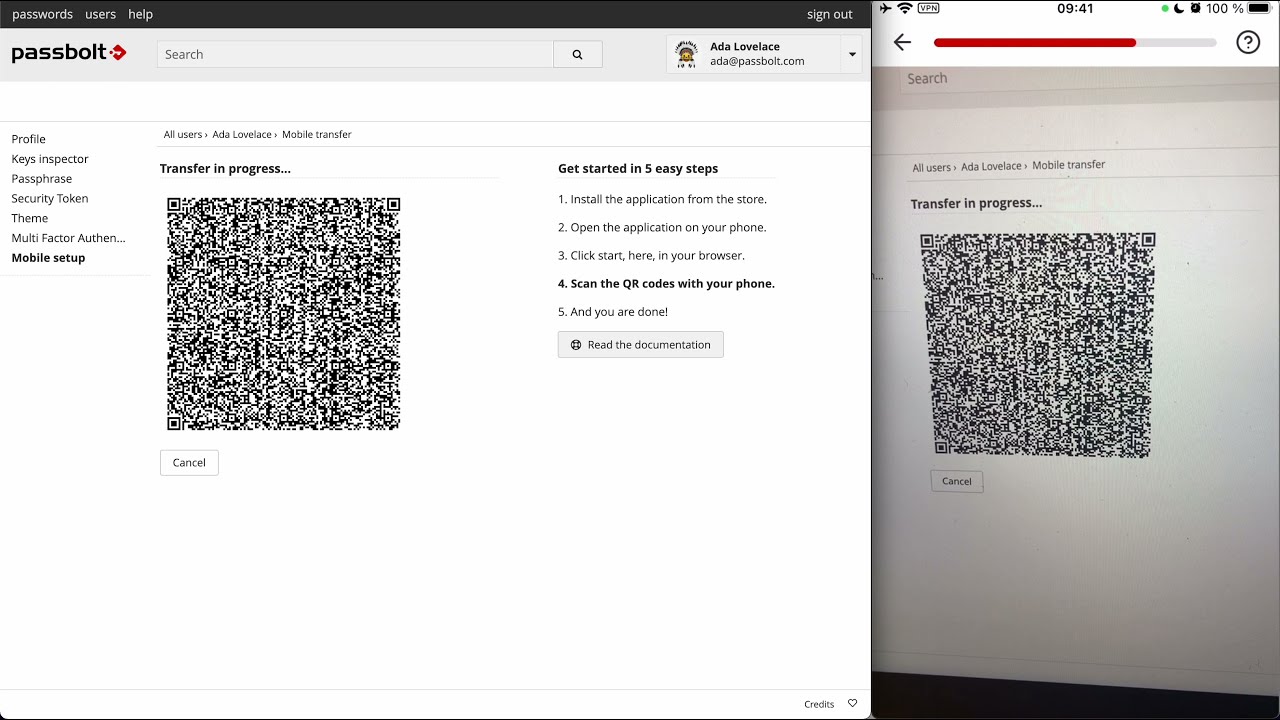

Hi,
Thanks for the good instruction.
After scanning the QR-Code, the iOS APP asked for Passphrase.
Now I entered my Passphrase and I get the error “Sign In failed”.
