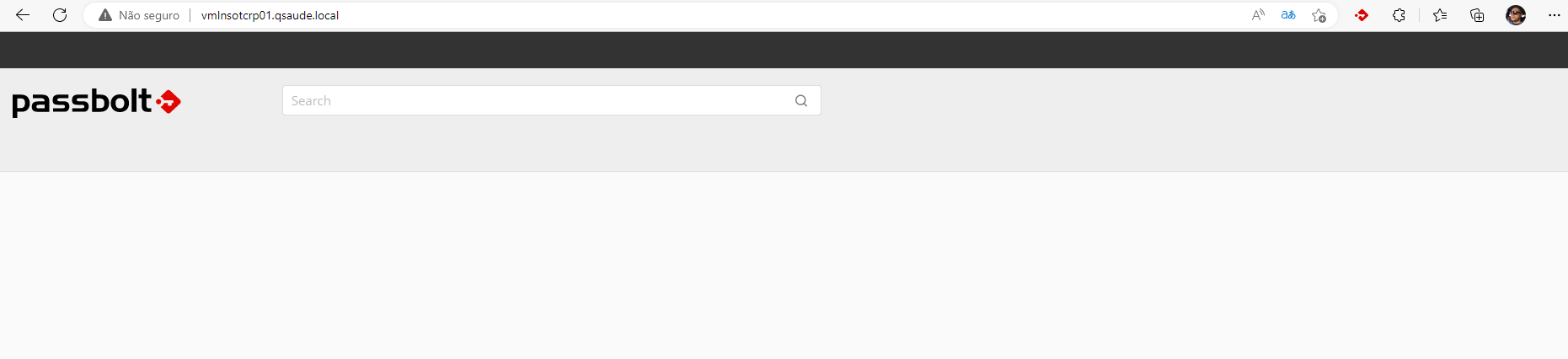

Pagina da Web não abre!
Galera estou com esse problema no navegador… alguém sabe me dizer o que possa ser?
ninguém mexeu no servidor
estava funcionando normalmente…
porem a pagina não carrega para ninguém
Hey @Fernandoribeiro07 welcome to the forum!
This is most likely caused by your server still being on passbolt v2 and your browser extension being on v4. To resolve this you’ll need to get your server on to v4.
You can do that by following the instructions here
Though you might want to change to a package installation and migrate to a new more up to date server. The instructions for those can be found here
