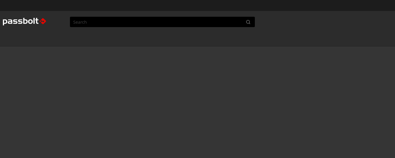

I am running what I assume is an older version of the Passbolt appliance that I am planning to migrate to a different platform but before I could do this I started getting issues with the Passbolt console properly loading and decrypting passwords with the browser add-on.
This is all I get when I log in to the console.
When I log in the following is written to /var/www/passbolt/logs/error.log
2023-10-10 04:22:57 Error: [Cake\Http\Exception\ForbiddenException] You need to login to access this location. (/var/www/passbolt/src/Auth/GpgAuthenticate.php:85)
Request URL: /users/csrf-token.json?api-version=v2
2023-10-10 04:22:58 Error: [Cake\Routing\Exception\MissingRouteException] A route matching "/resource-types.json" could not be found. (/var/www/passbolt/vendor/cakephp/cakephp/src/Routing/RouteCollection.php:216)
Request URL: /resource-types.json?api-version=v2
2023-10-10 04:22:59 Error: [Cake\Http\Exception\BadRequestException] The user id should be a uuid or "me". (/var/www/passbolt/src/Controller/Users/UsersViewController.php:39)
When I open the Passbolt add-on I see the following in the logs
2023-10-10 04:23:49 Error: [Cake\Routing\Exception\MissingRouteException] A route matching "/password-policies/settings.json" could not be found. (/var/www/passbolt/vendor/cakephp/cakephp/src/Routing/RouteCollection.php:216)
Request URL: /password-policies/settings.json?api-version=v2
2023-10-10 04:23:49 Error: [Cake\Routing\Exception\MissingRouteException] A route matching "/password-generator/settings.json" could not be found. (/var/www/passbolt/vendor/cakephp/cakephp/src/Routing/RouteCollection.php:216)
Request URL: /password-generator/settings.json?api-version=v2
and I cannot decrypt passwords.

Hello @spb ,
Indeed, you are probably running passbolt < 3
Since v4, there is some major changes, starting with the minimum software requirement being PHP 7.4. I see on the healthcheck that you are running PHP 7.3, could it be because you are on Debian 10?
If that is the case, I do not recommend to manually update the php version, I highly suggest to take a look at our migration guides in order to migrate to a new server. If you don’t want to be pressure by time you can take a look at this temporary workaround
However, prior to do any changes, please do not forget to do a backup of all your data.
