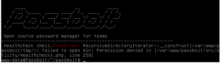

I followed the installation word by word but i cant reach the site.
When i do a healthcheck it gives me this:
Any tips?

@dario23 hello, you most likely have a permission issue on the tmp directory or the passbolt directory itself. The installation manual is battle tested so you most likely missed a step if it is not working. This or you should tell us more about your system (OS, webserver, etc.).

Can you list the permissions in your passbolt directory?
ls -la
Normally the tmp permissions are set by composer at the end of the composer install
step.
Alright, make sure you run composer install
again and press y
when it ask if it should set the permissions.
Ok, i’m not sure why you have no permission on that folder (compared to say /logs which looks ok).
You can set it manually:
sudo chmod 770 -R tmp
Okay i changed the permissions and it went well this is what i got after running the install again.
