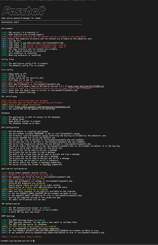

Sorry for being a noob, Here is the outout of the healthcheck.
Ah yes then this one:
su -s /bin/bash -c “/usr/share/php/passbolt/bin/cake passbolt healthcheck --smtpSettings” www-data
Thank you for the command, HEre is the output of the test. Looks like a few things failed.
