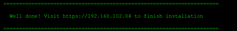

My passbolt work nicely but i have a problem. I made a manual installation of ssl certificates by following the tutoriel and i’m still in http and not https.
I create my key.pem and cert.pem like he say on the tutoriel Passbolt Help | Manual HTTPS configuration on Debian and Ubuntu with user provided certificates
But when it’s done my nginx work but i’m still in http.
I saw on Google they take the right key.pem and cert.pem when i make the installation but he say me that not a trusted certificates.
And for information i try to make the automatic install with let’sencrypt too with my port 80 open and he still give me a error.
Here some pictures :
In auto install :
Or if i put Domain name :
In manual install :
My key and cert is take by the setup
but when i make a nginx reload that happened :
So for now i have a passbolt working without https and i can’t reload the nginx :cold_sweat:

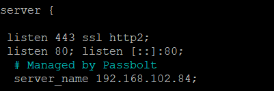

According to your latest screenshort, Nginx can’t reload because there seem to have multiple listen 443 or equivalent in the configuration file.
It is possible for you to investigate on that or to share your configuration to have a look here?

So for the Nginx, i’m gonna investigate to see why he listen multiple 443.
