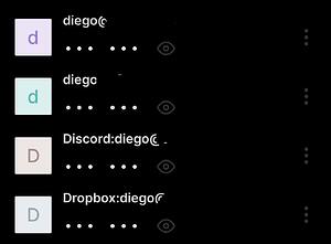

Maybe they are not sending the label field correctly and Passbolt just catches the email.
I noticed something similar with Facebook, where it shows only the username and not Facebook:username, showing like this screenshot:
