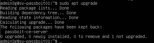

Still having this issue, not sure what’s going on!?

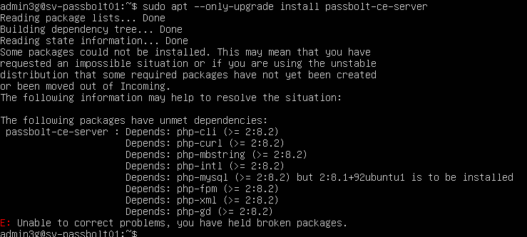

When I do apt --only-upgrade install I get this message:

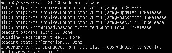

When I do sudo apt update I get:

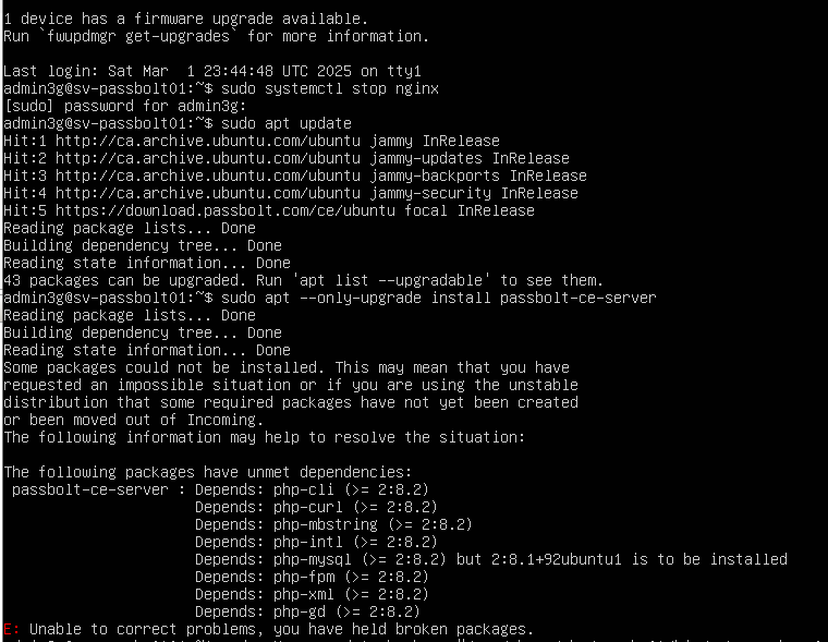

After I reboot and do the update again (sudo apt update) on Ubuntu 22.04 I get:
When I do sudo apt --only-upgrade install passbolt-ce-server I get:
