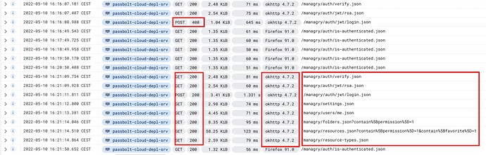

Hi @karelklic
We see in our logs this 400 error but it is followed with a successful connection (return code 200).
User agent okhttp is the mobile app.
Did you finally manage to use passbolt on your Android smartphone ?
Best,
