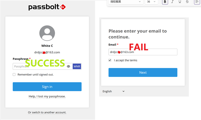

And if I click “Or switch to another account.” on login page, and then use the ative admin email to login, it can’t login, tips Check your mailbox!. Maybe something error in install progress.
