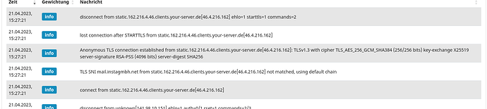

Yes, and what are the mail server logs showing when this was sent?
