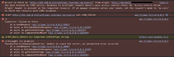

I am NOT using Docker or HTTPS/TLS, everything installed in a Debian 12 VM with just HTTP Passbolt installed, and Traefik on a different VM. I can access Passbolt using the IPv4 with no issues, but as soon as I use the domain name, which goes through Traefik, I get the bellow CORS error. I am uncertain if something requires changing on the Passbolt side. I have provided the NGiNX Passbolt for reference .
Uncertain why I cannot bypass the CORS error with the below Traefik settings:

Hello @habitats-tech and welcome to the forum!
There is most probably a configuration mismatch somewhere.
I suppose that in your passbolt.php file of your instance the fullBaseUrl is set with the IP address instead of the domain name.
Can you give a check?
