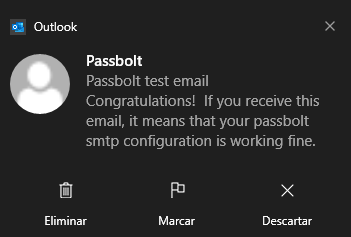

This command works fine.
su -s /bin/bash -c “/usr/share/php/passbolt/bin/cake passbolt send_test_email --recipient=myuser@my.domain” nginx

Works fine.
su -s /bin/bash -c “/usr/share/php/passbolt/bin/cake passbolt send_test_email --recipient=usar@my.domain” nginx
