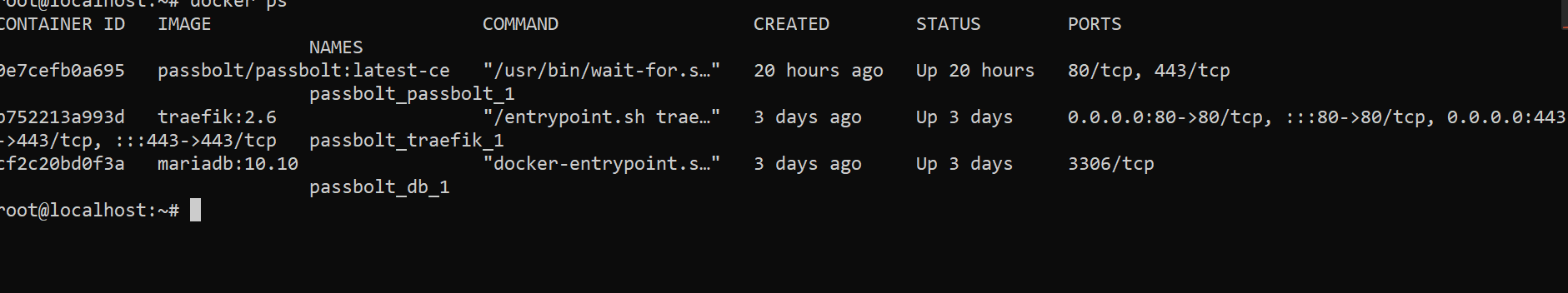

  • Can you run docker ps and make sure the 3 containers are all up and running?

it all looks right to me but I don’t know…
here is what I’m seeing
All of the configs look the same with the exaption to the stuff I had to change like my email in the “traefik.yaml”
Ok, all the files are there.

PIC of my working passbolt YAY
Nice @dgibbs3196 !
Glad you got passbolt up and running
And yes. Containerization can do nasty things sometimes.
Keep it up and enjoy passbolt!
