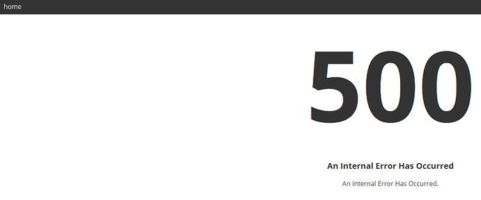

getting the error
Config file “passbolt.php” did not return an array
I noticed theat the ownership of passbolt.php was different than the other files, so I changed them so they are the same. Now I get:
