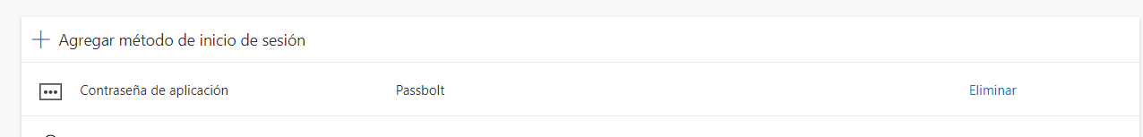

My authenticator method is as the picture below
