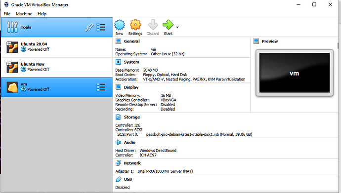

I also tried this one Passbolt Help | Using Passbolt pro virtual machine appliance and already downloaded the ova and the SHA512SUM.txt but when I boot in the VM it is only black.

You got a black screen because with Virtualbox, default selected system is a Linux 32-bit
You should select Debian 64bit:

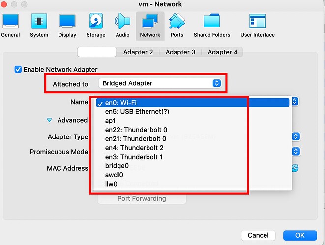

10.2.0.15 is the default virtualbox NAT network, you won’t be able to reach this IP from your computer.
If you want to use NAT, you have to define port forwarding:
As an example, here are my settings:
  • 8080 to access to VM port 80
  • 4443 to access to port 443
  • 22222 to access to ssh port 22:
I usually use bridged adapter to “plug” my VM network to my Wifi or Eth card:
Thus, I can use my home network to access to my passbolt VM. If you choose bridged adapter, you should fix the IP address:
Hope this help :slight_smile:
