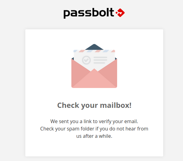

- I read you can activate users by opening “./bin/cake passbolt register_user -i” and it works, a user looks as activated and you imagine the need for email activation would end there. However if you open Passbolt in another browser you get greeted with another email activation warning:
- activation emails
, verification emails
, notification emails
, all is an email. Dealing with passwords is hard already but keeping up also with email configuration is too much.

Hi, I followed the procedure for manually activating users without email confirmation however as soon as I’m on another device/browser I need to open confirmation emails (I added a screenshot in my first post).
So in my opinion it should be clearly pointed out that: an email address is strictly required unless of course you want to be locked out the first time you are required to open a confirmation email!

All new device registration involves the same process you were able to do without an email. When you want to set up a new device, just repeat the process to get the link again. Same idea as before except it’s a recovery process, not initial registration.
