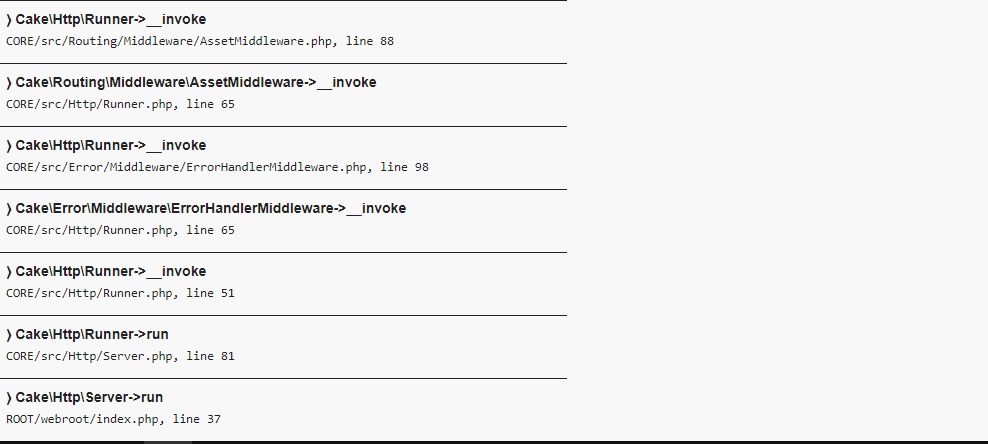

Enabled debug option and attached is the screen shot with the information

@luis.horna
Could it be related to selinux ?
selinux avoid db connections from the httpd server to the remote db server.
https://stackoverflow.com/questions/34673627/sqlstatehy000-2002-permission-denied
